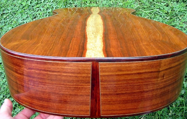

Great choice Larry! I'm finishing up my first GC right now. Great shape! I got my plans from a link from Kathy Matsushita (the Wolf guitar, if that helps). Think I paid about $12 for plans about 5-6 yrs ago. Not sure of their accuracy, but PM me if you want to talk. I'll be posting pix soon. The KTM-9 came out very well on this one. (I shoot for being able to read the small print from a light bulb reflection, clearly over the entire guitar.)
Anyhow, I plan to make a bunch of these GC guitars. Here's what I've got from my templates. May not be exactly what Taylor's are, but that's irreverent. (And irrelevant!)

Here's a sneek peek from when I Z-poxied it. It's MUCH shinier now with the KTM-9 buffed out. Just have to wait for it to stop raining to get another outside shot.
